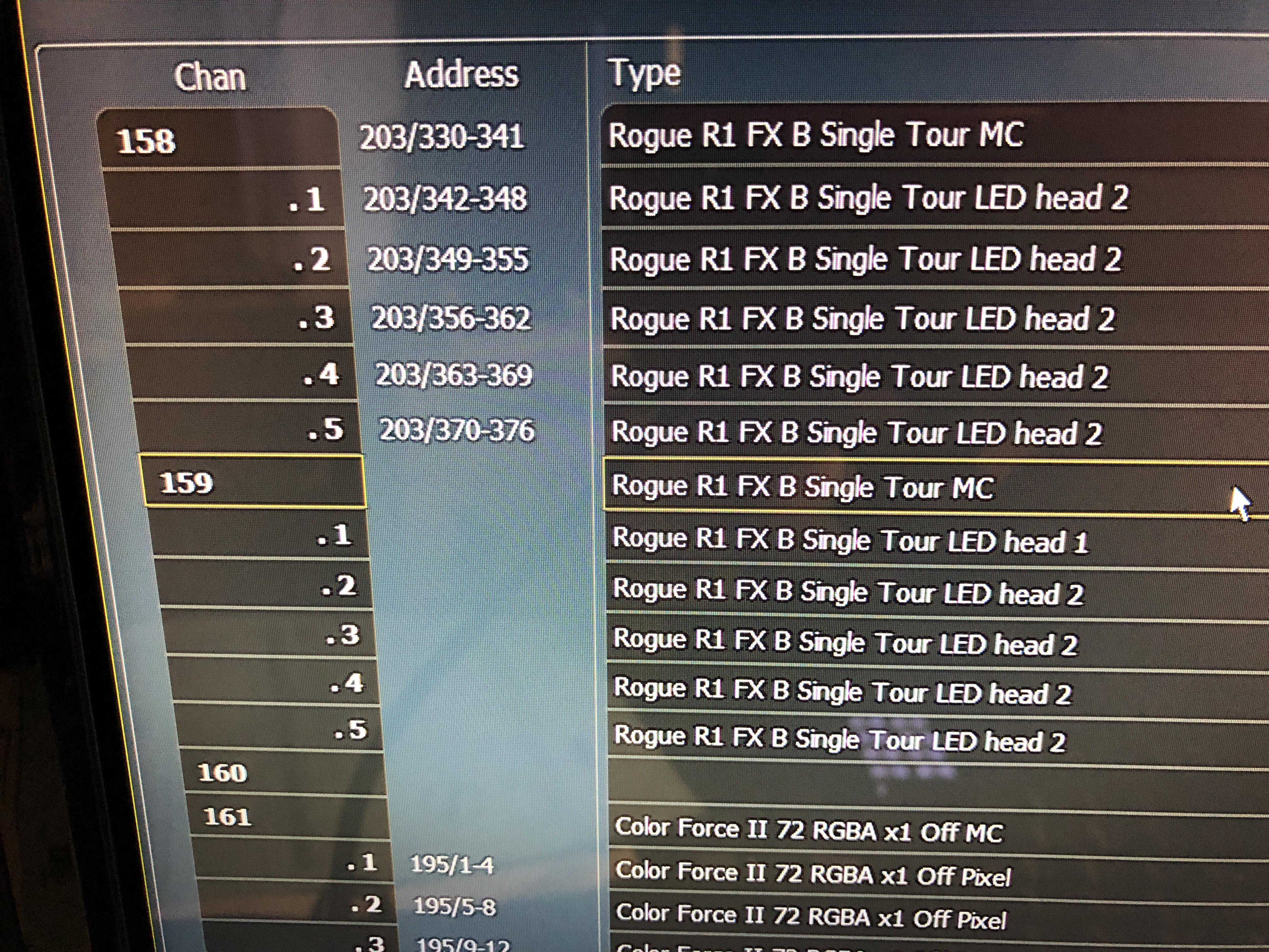

I discovered that the profile for the Rogue R1 FX B Single Tour Single Tour MC does not work properly.
The profile by default assigns 'LED head 1' to cell 1, and 'LED head 2' to cells 2 thru 5. Changing the type on cell 1 to be 'LED head 1' makes the fixture work properly.
In the attached photo (158) works, (159) will not work.
