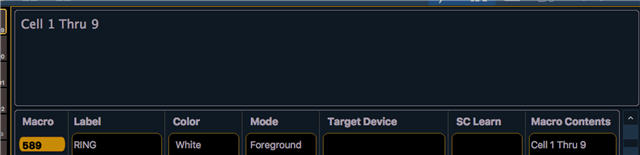

- I have 2 macros that select ranges of cells within my Channel Groups (One macro selects Cell 1 thru 9 and the other selects Cell 10)

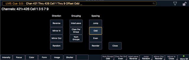

- If I enter my range of channels and cells on the command line then Offset Odd, everything works the way it should.  This is expected behavior:

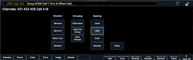

- But if I select a Group instead of the range of channels, then click my macro to select cells 1-9, I get a normal post on the command line and the correct cell selection.  No errors. If I make level adjustments to this channel selection as is, everything seems to work fine, no problem.
- But if I refine my selection by typing Offset Odd -- instead of selecting the odd cells, it selects the odd master channels, instead of the odd cells:

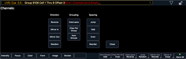

- If I type Offset 3, my selection disappears entirely and gives me a "Channel list is empty" error if I try to terminate it:
