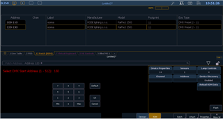

  • the fixture has the address start 120….I change the address start to 150 (push OK).

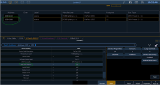

            Now we do reload RDM Data (yes) ... up to here, correct (see signage with green circles).

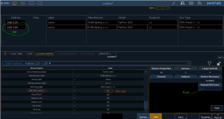

            Now I want to change the address from the own fixture (without using RDM), in Robe, Set DMXA to Add 120 ..... then in EOS Reload RDM Data (OK) .... and what happens? in             Device Properties the DMX Start Address still contains the previous address 150 .... It has not changed.

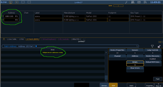

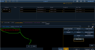

  • Second question: Two fixtures addressed to the same address, EOS notifies an Error (Multiple devices` addresses overlap) ...... I want to erase, clean the "Error" .... I execute Clear Errors and then refresh (Reload RDM Data ) ..... but the Error, warning remains, persists .... the information is not cleaned.
