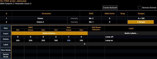

  • I made this fixture, which I think does what you need:
    I chose to have the lamp on/off not in lamp controls but in Intens2, because I wanted to be able to switch the lamp during the show to prevent overheating the dousers
  • Thanks it work but i think it's better with LAMP CONTROL parameter for first data channel
