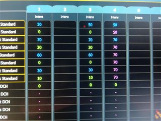

looks like there is a bug when using Copy To ... HTP on multiple Cues in Blind.
Following picture was taken with the console in Cue Only mode. Chan 1 had the values, 3 and 4 had none.
Commands:
Chan 3 Recall From Chan 1 HTP
Chan 1 Copy To Chan 4 HTP
I'd expect the result to be the same on channels 3 and 4. Looks like Copy To ... HTP uses tracking mode here.
