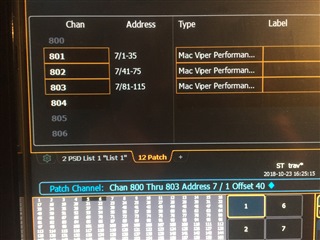

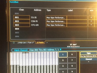

When we patch in Viper Performances or Profiles, it seems that 5 channels are being dropped. Despite the library saying that the Performance in 16bit Extended should have 40ch, only 35ch end up being patched . With the Profile it patches in 29 instead of the listed 34. This is then compounded when patching in multiple fixtures. We can get around it by using the offset, but with multiple venues and multiple operators it's a bit of a mission to make sure everyone is across it.
Pics attached of patching multiples with and without using the offset..
