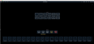

  • Are you looking to make it so anything that's set in snapshots to come up in screen 1 will come up in screen 2 & vice versa??
    If so, there's a relatively new feature in the software. On either window, click on the little monitor icon in the upper left corner. That'll bring up the following screen:
    In the row of 'Options' toward the bottom, click on the 'Monitor Mapping' icon. That'll pop up a window with your screens. If you click on screen  1, you can assign it to be screen 2. That'll make screen 2, screen 1, automatically.
    Now, any snapshots that bring things up in 'Screen 1' will bring them up in the old 'Screen 2' (Now Screen 1).
