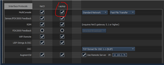

Nomad connection issues: getting my ION v2.8.1 to talk to Nomad v2.8.1 on my windows 10 Laptop using Port 2
This connection works on Port 1 but fails on Port 2
On Port 2 The PC nomad cannot find the master..
The ION is enabled as a DHCP server. The PC sees the server and is getting the expected address from the ION
While on Port 2 I can Ping both ways and get a response.
Is this a hardware problem with this desk or something I'm missing.
Its also the same if I use manual addressing.
The "network" is just the ION and the PC, nothing else is connected except prepherals (not even dmx)
