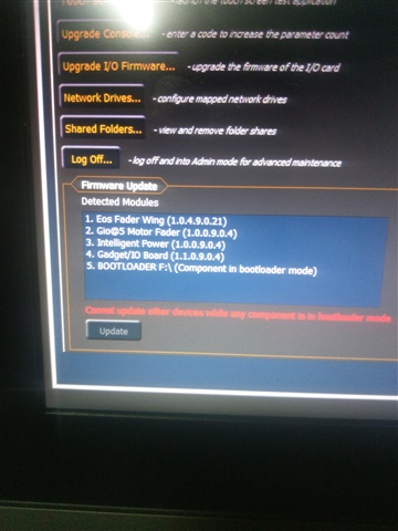

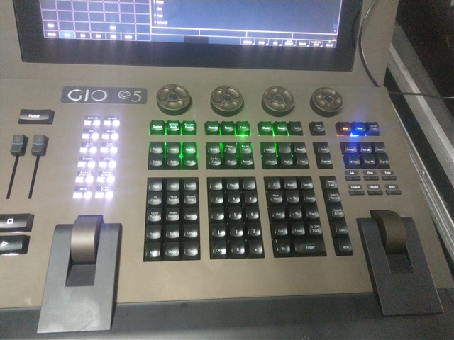

HELP
up date error
Touch screen error
keyboy error
How can I solve it?
HELP
up date error
Call one of the ETC offices
We need to drop the firmware file onto the device in bootloader mode to resolve this, and then fully power cycle the board.
If you are getting this message immediately after attempting a firmware update and have not yet rebooted, please do so first.
Then, give your local ETC office a ring and we can walk you through loading the firmware safely-- as Ueli suggested.
