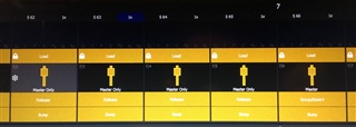

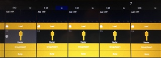

I'm having an issue with a group of faders on my console.  When I populate fader 62-65 with a submaster, my fader and buttons are set to the default submaster settings: Master, Group/Assert, and Bump:
But when I delete those submasters, the config on those faders changes to Master Only, Release, and Bump, and the LEDs on my fader wing start blinking because the console expects the Master Only faders to be at 100%.
This is only an issue with Fader 62-65. Fader 66 retains its default submaster config when the mapped sub is deleted, as expected.  But fader 62-65 change and the LEDs start blinking.
