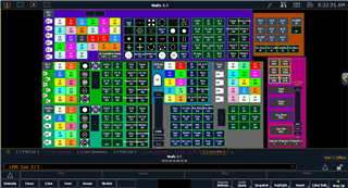

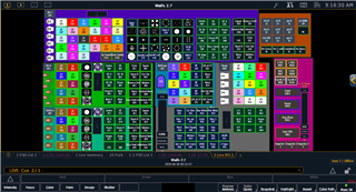

I have attached snapshots of magic sheet 1 (as example) for version 2.7.3 and 2.8.3. no changes to the file just different OS version. I have tried to insert the show-file as well, however it comes up with an error.
