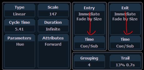

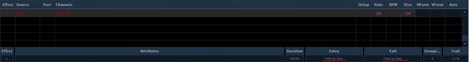

    To set Times for a running Effect or an Effect-instance recorded to a Target, hit [Effect] once to open the Effect Status Display in the CIA.
    Changes made here will only affect this specific Effect-instance. The Base-Effect and all other instances in the showfile will stay unaffected. To get to the respective time-settings select the Entry- or Exit-Field.

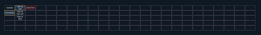

    This shows the Entry- or Exit-Attributes. To set times select the Entry/ExitTime-Tile and enter the desired time.
