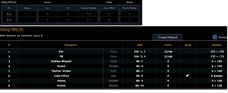

I made a profile for some small U'King MH's. They are in ten channel mode. We only really use Pan, Tilt and Intensity and things are working fine (except for some "Home" position issues I' m sorting out now)
But here's the thing; My Profile (see picture) has all the 10 channels accounted for, but the display, when the channel is selected in Live shows only 8!
The 10th spot is important because in it the fixture has a "Reset" value. By that I mean that if I could see the 10th in the display and enter 255. The unit should reset after 5 seconds.
Bottom line - how can I feed a value of 255 to channel 10 of the MH?
