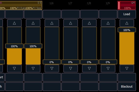

i have a fader as a grandmaster configured. The hardware button for blackout on this bader does not works on the Ion Xe 20 console (also 20er mot. wing). The software button works.
you have to press both buttons below the fader together. think of it as additional safety to not black out your whole stage just because you hit the wrong bump button ;)
Thanks for the quick answer... I test this tomorrow sometimes. However, this makes sense.
