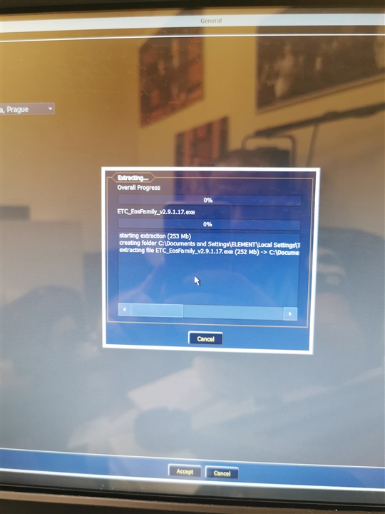

i think that my version is with xp and i have vga output and two dvi. and just one netvork port. :(
Could element read win rar zip? Its bean stuck on instal window more than 10 min.
Unzip before copy the .exe to an usb stick.
Tnx
Ok so now my element showing a mistake '' the specific I/O operation on device\ harddisk1\ DR4 was not completed before the time out period expired " And i canot vontinue instalation? Eny advice?
call tech support
Ok :( thank you
