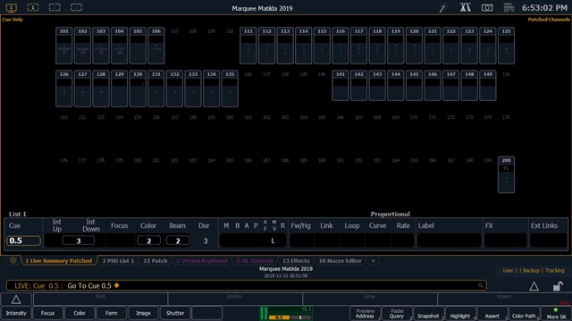

Here is a screenshot of our Nomad Laptop screen. The view is Live Summary Patched. I tried deleting unused channels in patch on the Nomad, but they would not delete.
You activated 100 channel display. It's in the Live displaydisplay menu
