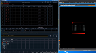

Effect 901 Can it be rotated symmetrically? Thank you
