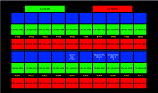

I'm trying to display, in my magic sheet, the level of a parked channel.
Somebody advise me to try by displaying the dmx value of an adress item.
It works, but I noticed that if this adress is not patched, it won't display his value.
My problem is that the adress of my channel change every show, so i will need to modify my magic sheet at every time I change my patch and this is not the purpose of what we trying to have in our basic showfile.
Our magic sheet allow us to power-on our non-dim channels with macros that already exist in our basic theater showfile. The channels already exist too.
We just have to patch their adress (fixed adress) but not in the same universe and not for the same type of fixtures.
So, we use 3 fields of text in the patch to see on our magic sheet, which machine the macro is corresponding to.
But when we fire a macro, we would like to see on our magic sheet screen, if the macro has been really fired without opening the park display, so that's why i'm trying to display the parked channel value in my magic sheet!
