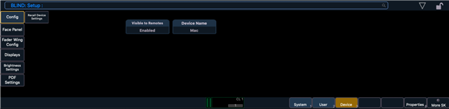

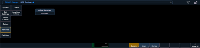

I have checked all the places to tick for allowing remotes (maybe in v3 this could be streamlined to one place?)
And I have tried with and without the Device Name as Password.

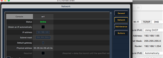

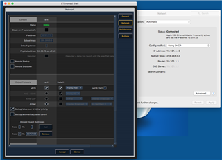

The one weird thing I do notice is that in the Mac EOS shell there isn't an "RFR" button, but also in the Network settings it doesn't go past the "Interface Protocols: OSC" group. I also noticed that the on the Mac the "obtain IP automatically" is unchecked, and whereas the PC is checked. Also, just realized as I compare things that the Mac is also not showing any "Gateway" which I'm sure is the main source of the issue. This seems like an issue for the EOS software not seeing the computer settings somewhere.
