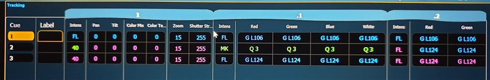

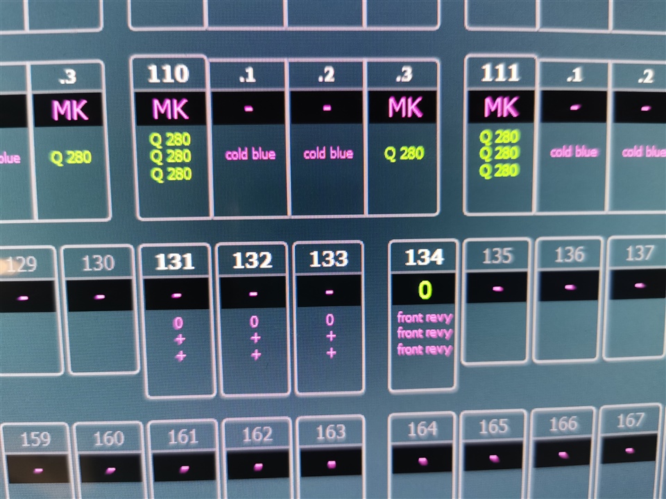

I do have a bunch of Robe 600 LED Wash in Mode5 (MC controll of rings).
EOS 2.9.1.17 and the fixture profiles updated to this library.
If i like to bring them up, i would need to select the master and the cells individually. That's very uncomfartable as you would need to select two groups. TO solve this i setted the Home of Cells intens to 100. That helps bringing them up in the used way. But then they wouldn't (auto)mark properly although their master intensity is not on and they are not outputting light.
In the end i think they should mark no matter if the virtiual intensity or the master intens is of.
Setting the Cell as remote Dimmer wouldn't work, as you would only be able to controle the cells individually through the color.
Any clever solution out there?
