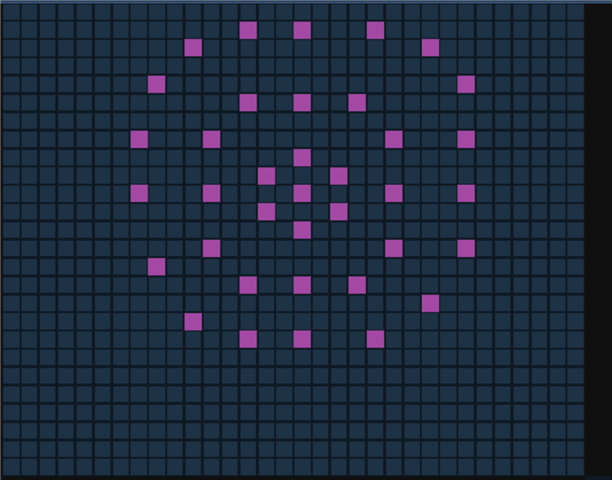

its the changing the channels. Is there a fast way to change 30 cells of one channel to the same cells on a new channel?
Example. This is my sola wash 37 layout for chan 71. Can I copy this to a new pixel map and to chan 72.
So here is Pixel Map 1. 10×10. Address 7/1+
[Copy To] (2) [Enter] Copies the Pixel Map 1 to PM2. (Copy To will autoselect the Pixel Map)
Then I change the assigned addresses (to 8/1 here) and we're all set.
If I wanted, I could change the Effects Layer channels so each pixel map has their own effects generator.
