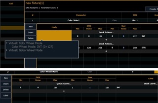

We have a really simple little light. It has 4 channels 1 multipurpose, and 2, 3 and 4 for R, G and B.
It is that multipurpose causing my headache.
Purpose                      Value
Off                                0
Brightness                    1 < 127
Flash                             128 < 250
Peg Intens at 100%      251 < 255
I am trying to separate chan 1 into two modes (only) The 1 < 127 for Intensity and 128 < 250 for strobe. But keep messing things up!
I made my Select (Picture) and then the two modes (one of which is in the picture). Back in the select though I can 'see' the Virtual modes I can't select them.
The end game is to have a INTENS and STROBE button in the ML panel and then clicking on one or the other move them through their allowed values.
