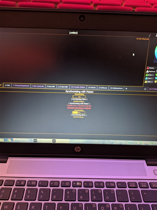

Hello guys, I have a wired network with Rpu as primary and Ti as backup. An l want to join with nomad wirelessly as a client. Connection Always fails.. any solution?
Connecting a client wirelessly directly to a network isn't supported.
The standard method is to set up a hard wired nomad client and then use remote desktop to access that client wirelessly.
Its failed every time at 40%
(My wireless Access point linked at 120mbps...!) So i dont think is a speed problem here..)
sktusing is correct. Wireless client is not supported. Unlike connections with your web browser, if the download is interrupted for any reason the entire show file must be re-synchronized. If that file is interrupted while downloading for any reason, including wireless access point normal wireless traffic management, it has to start again from the beginning.
Your best option is to use a wired connection to your lighting network.
