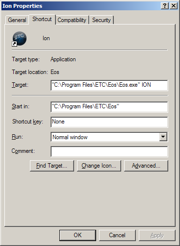

  • Hi Mark,
    The same principal applies to Mac.  You can start the application directly with the command line parameter ION or ELEMENT.  I can't seem to figure out how to do this with the Mac version of Windows shortcuts (Aliases), but in a post further below you will find 2 Apple scripts to launch in fullscreen Ion mode and fullscreen Element mode...
