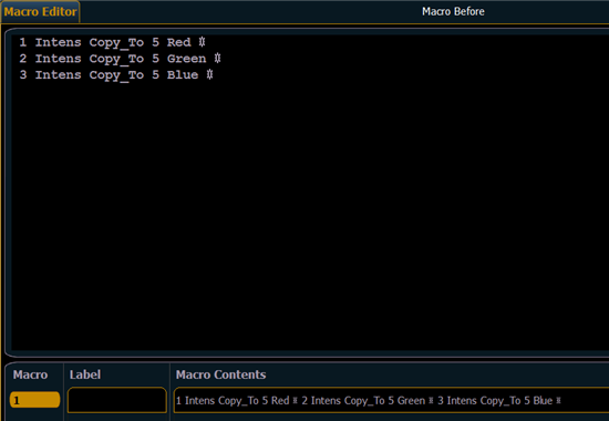

  • I believe the key to making this work is to make sure that you are including {Intens} in the macro.
    e.g.
    1 {intens} [Copy To] 5 {Red} [Enter]
    2 {Intens} [Copy To] 5 {Green} [Enter]
    3 {intens} [Copy To] 5 {Blue} [Enter]
    Try this using the macro editor to build the macro.

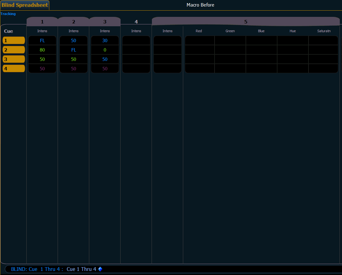

  • I just tested it in 1.8 to sure and it does work.  Be sure that you are using the macro editor to build the macro.  Also, when you are done the macro should look something like the photo I attached.

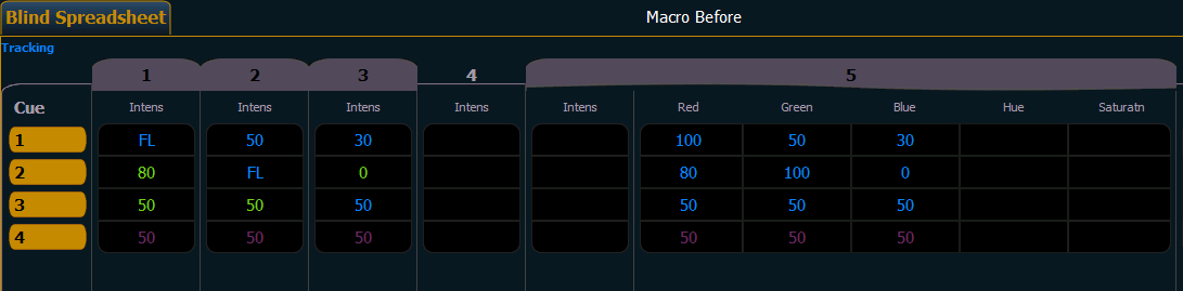

    Here is what the execution looks like.
    Select the Cues in blind Spreadsheet.
    Then, run the macro.
  • Just worked for me as well in the 1.8 OLE.
    -Josh
