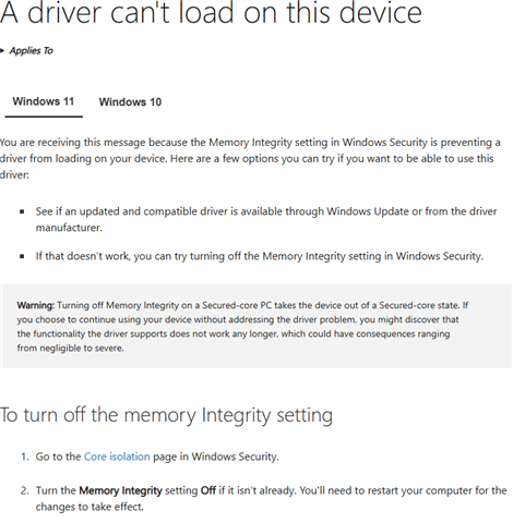

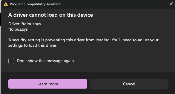

I attempted to use my University's Universal Fader Wing on my Windows 11 Laptop, but it is no longer properly working. A couple weeks ago I had it working just fine, everything was responsive, even used it for a show! But all of the sudden, my laptop is now giving me a message in Device Manager stating that "Windows cannot load the device driver for this hardware. The driver may be corrupted or missing. (Code 39)."
I have completely uninstalled & reinstalled the drivers, Nomad, and pretty much everything I can do except re-install Windows, which I'd prefer not to do.
