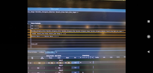

I'm working with a director who is very sensitive for live moves, so i was trying to create a macro that recalls all non-intensity parameters from channels a couple of seconds before it recalls intensity from the same channel.
I did a similar macro that sneaks in the same way. In that sneak macro i just made 1 macro that sneaks everything but intensity and a 2nd macro that sneaks intensity with a delay of my default sneak time. Then i just made a 3rd macro that runs the first two.
This method did not work for 'recall from', it just gives me a synthax error.
I'll put a pic of my current macro lines below.
Any tips are greatly appreciated!!
