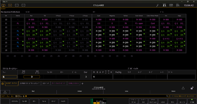

is there any way to get rid of the unwanted specific parameter block?
The underlined blocks are called autoblocks and show up as b in the PSD. You can get rid of them on a cue by cue basis or for the whole cuelist, depending on your situation.
For the whole cuelist: [Cue] 1 [/] {Autoblk Clean} [Enter]

I already tried the Autoblock Clean but it does not work.
also there is no b in PSD
is there something wrong with Mark function or something?
Try 13+14+16+17 color @ enter update
I'm not aware of a bug that would explain this. If you want to send us the showfile to eos(dot)moderator(at)etcconnect(dot)com we can take a look.
