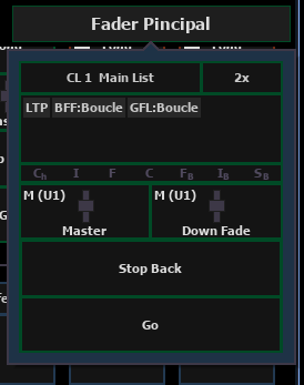

Anytime I hit “ go”, the lights fade into a blackout instead of progressing to the next cue. Also, when i hit “go”, it clears the ion board screen. Any ideas?
In tab 36 "config faders", main playback, check if you go button is set as "go" instead of "off"
That was it, thank you
