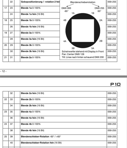

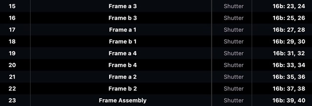

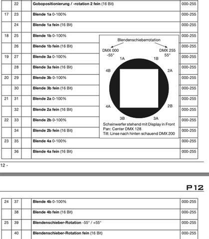

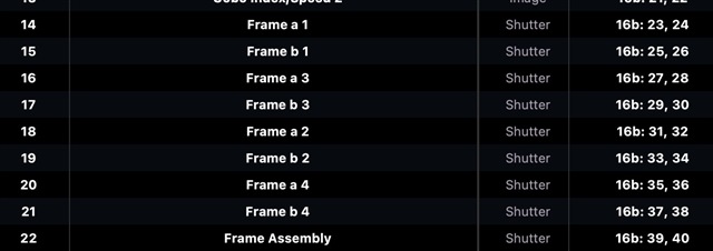

JB lighting makes the P10 and P12 fixtures with the same shutter order in the dmx chart. The order of the shutters in the Eos library is different for both fixtures. I cannot tell which is the correct one. So please could someone at ETC file the error in their brilliant Fixture library hub, since I have given up on that. Thank you in advance!
P10:
P12:
