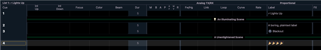

The good: Eos does, to some extent, support emojis! Using the offline editor (MacOS), I was able to copy-paste in emojis into cue label and scene fields from within Eos as well as over OSC. They render properly, everyone is happy:
The problems come when saving and then reopening the emoji-fied showfile:
All labels and scenes with emojis now do not exist Sob! Some emojis do still sorta work after saves, but when entered they degenerate to a non-emoji symbol -- for example, the High Voltage emoji Zap, colored yellow, becomes a simple text lightning bolt symbol (Q1) when copied in.
