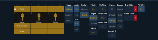

Thanks for the help. With a few monkeys and typewriters I managed to get the faders working with the submasters. Whilst hitting random keys this came up. Can you tell me what this does? Is there any documentation on how to use Nomad. It does seem to differ in places when compared with the physical desk.
Other than using virtual controls rather than physical (hotkeys rather than a facepanel, virtual faders instead of real ones) there isn't much different. It is after all the exact same software.
The screenshot you posted is the same on the console and on nomad and it's used to change a sub's properties. You can get it through [Sub] 1 {Properties} or with [Learn] & [sub's Load button].
