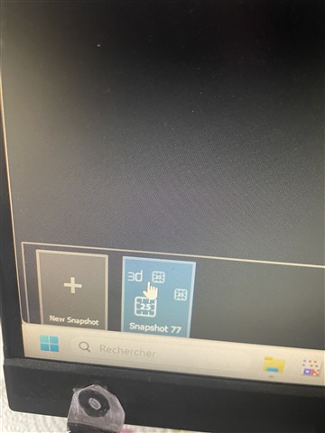

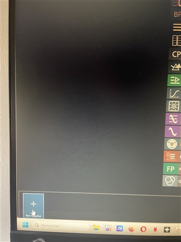

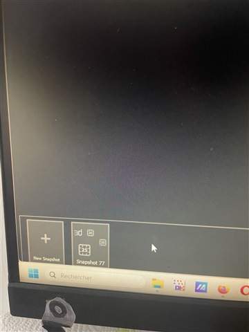

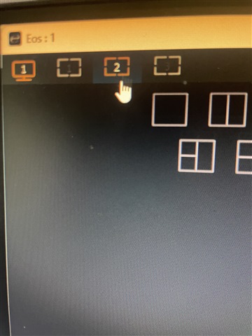

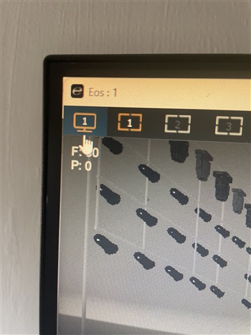

Hi,
1-while in your first workspace, open workspace editor
2-create one snapshot here, the simplest snapshot, it will take only the active workspace from the selected monitor (workspace 1 in this case)
3- then select your second workspace
4- press yur new snapshot
done.

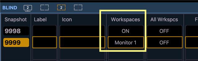

Note that those snapshots created here don't appear in the snapshot popup but are visible in the snapshot list.
Thanks Passa,
I tried to alter the parameter 'Workspace' from 'ON' to something 'else' from within the Snapshot tab. I could not find the right softkeycombination there. It seems this can only be achieved by the (obscured) method you show. Thanks for showing. I will try this way.
