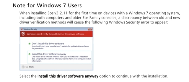

Was it this message? There is this short explanation in the release notes:
Will the message pop up when I install again?
It will show that red warning everytime you update to or past 3.2.11 until you hit the Install this driver software anyway.
