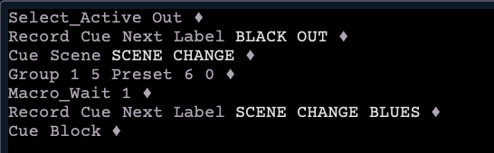

Hi all,
I have the following Macro that seems to halt at the preset ENTER line:
I cant seem to get it to run the rest of the macro..
any help would be appreciated!
Thanks!
Hi all,
Thanks!
Macros and labeling don't mix well.
Try making the label-part it's own macro and see if that works.
Thanks for the reply - I've removed the labels and it still gets stuck at the preset 60 [ENTER].
Scene is sort of still a label - I think the underlying bug is related to the virtual keyboard. Here's a thread with some more info.
