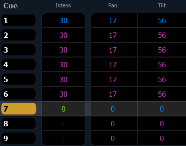

I'm seeing some strange behavior of Trace in combination with Block that i don't understand:
this is the starting point, cue 7 is blocked.

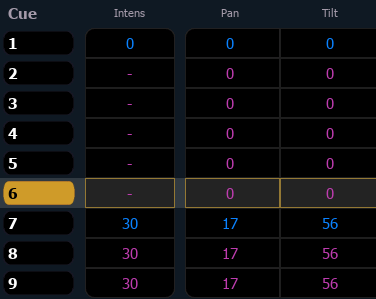

Chan 1 CopyTo Cue 6 Trace Enter
I understand what happens in cues 1 through 6, it's what i was expecting. but why do the values of cue 6 suddenly show up in cue 7 (and 8 and 9)?
