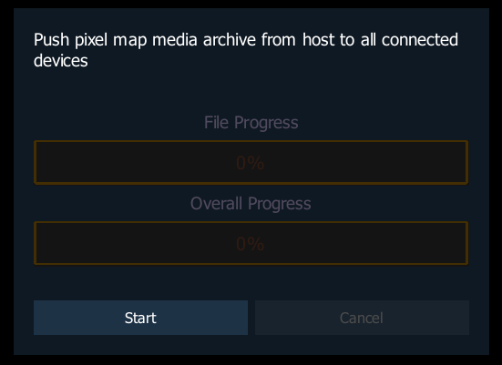

    Starting in 3.3 you also have the option to use this function in Setup > System > Session:
    This will use significant network bandwidth. It is recommended that you do not push media during a performance. Please also note that this will overwrite existing media on the target devices.
