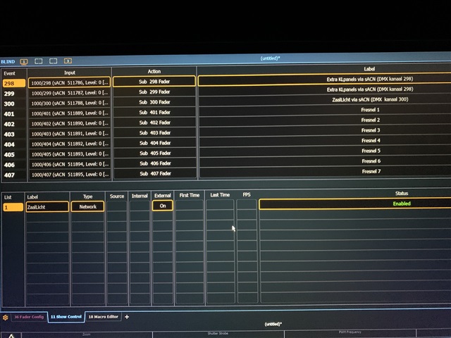

Eos v3.3 Bug in Show Control (editing the Events, will not seen as a update in the showfile!)
During re-programming the Events (List 1, Network type, sACN to Sub Fader control), the edited events where not saved after shift update.
Normally you will see a * when there is something changed in the showfile, but not during editing the Events.
After copy Event list 1 to Event list 2 and then deleting List 2, it helps, so the updated and added Events are now saved in the show.
