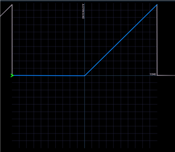

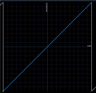

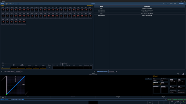

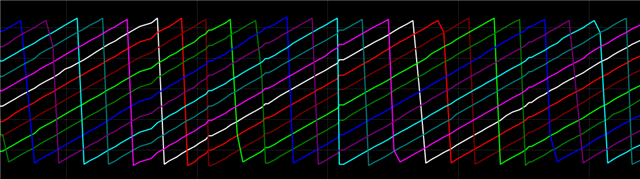

My Steps to Reproduce this issue: Create a Linear Effect with a Saw-tooth Pattern; Change the Effect Size to 50; Select Multiple fixtures (in my case generic Dimmers) and set them at 50; Apply the Effect to the selection; Decrease the Effect Cycle time down from where its currently at.
Expected Effect Pattern:
Actual Effect Pattern being output (from what i can tell):
From what i can tell, this anomaly only happens when using some variation of the Saw-tooth pattern. Found this randomly while programing and wanted to investigate further. I'm sure this can't be expected behavior.
