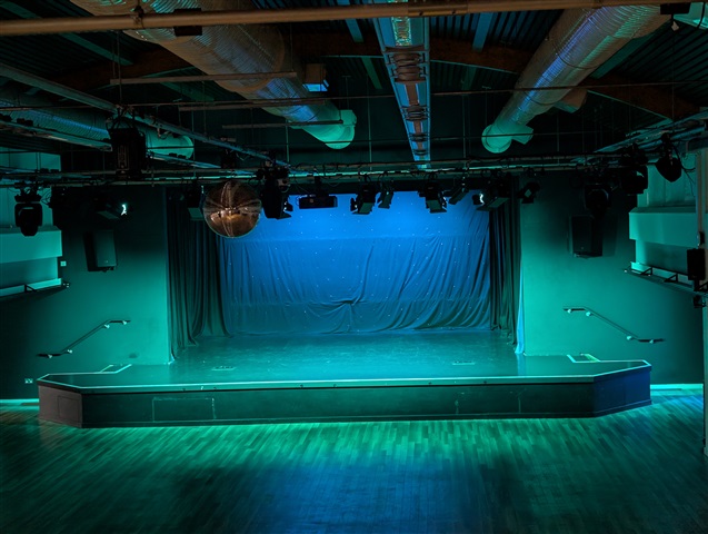

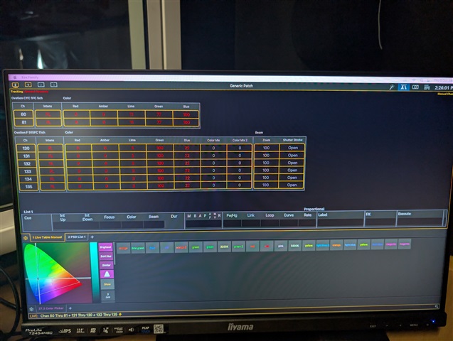

For example, I have put my cyc lights and front wash on at full and selected a teal shade I liked the look of. I was then provided these values:
And the stage looks like this:

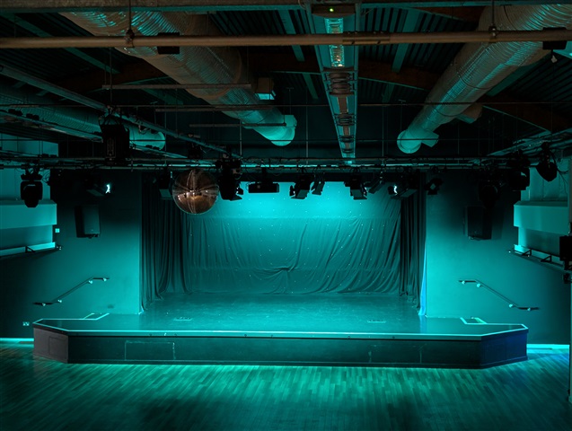

We currently have a star cloth hung which doesn't reflect the cyc lights as they usually would be, however that is a noticle and distinct difference in shades of blue. I then have manually changed the values of the cyc lights to match the wash and it now looks uniformed:
