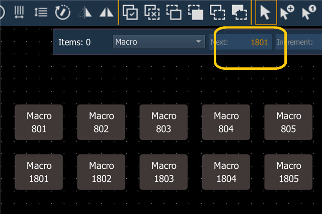

Thanks, copying objects is no problem. What I'm looking for is how to copy objects and renumber them all at once.
For example, I'd like to copy all the objects and change their numbers without having to do it one by one (macro 801 to 819, copy them to 1001 to 1019). After, of course, having already copied the macros themselves.Ah, I get it.
You select your macro objects 801 through 819, Ctrl-C. Before pasting you change the Next number and then use Shift-Ctrl+V to insert and renumber.
Ah, I get it.
