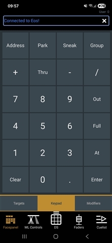

i have some trouble with the remote control app.
Originally i thought it was a problem with the access point.
I was told about the problem but never had it when i was at work but this days i had it too.
The issue happens irregular. I think it starts with Eos 3.3.4 or maybe earlier.
Now i am running Eos 3.3.5 and its still happen.
As the image shows the comand line shows there`s written "Connected to Eos!" but its in blue like being in blind mode. As i know there`s no live button on remote control. At the desk i changed the same user but there i am in live mode. I am not shure why the app displays user 0 because by default i am another user number.
I am connectecd to the wifi and remote control and osc is activated but i am not able to control chanels.
It happens on andoird and ios and the problem got fixed by restarting the console.
