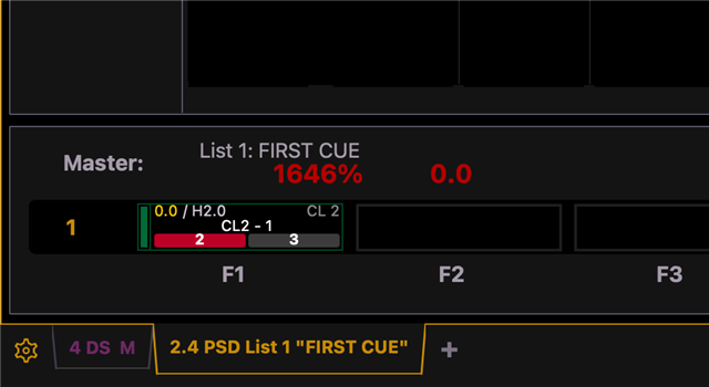

Intermittently, the cue runs beyond 100% and OSC messages like this are generated;
OSC 2026-02-04 23:15:12.579 [USB 3] SEND [OSC Packet] /eos/out/active/cue, 551.820(f)
OSC 2026-02-04 23:15:12.579 [USB 3] SEND [OSC Packet] /eos/out/active/cue/text, 1/100 Cue 100 -8262.4 55182%(s)
Showing the cue in this case at 55,182% with -8262 seconds remaining.
The PSD shows an incrementing red percentage with a time of 0.0
The actual output is as if cue 100 stopped.
