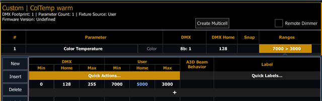

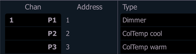

I realize I may have misread your question. I can offer a profile that does control cool and warm through one single parameter. However I don't see a way to do the color control through one single DMX address if the controller of your LED strip doesn't natively support it.
The cool white fixture profile is a copy of the warm, the only change is that the User Min and User Max values are swapped.
I chose 3000 and 7000 arbitrarily as Kelvin amounts representing the warm and cool mixed colors.
