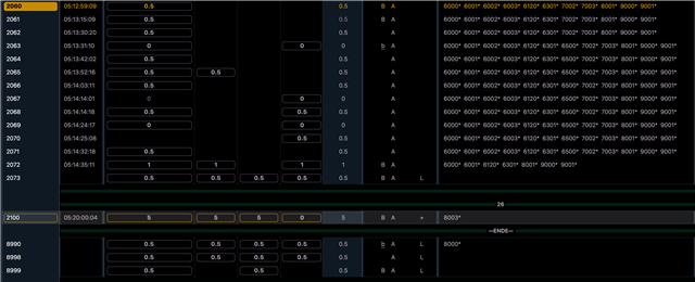

I have the follow constellation of effects and cues:
If I now move or delete (in this example I delete them) cues 2061 thru 2072 some effects, that started in cue 2060 and had previously been stopped in cue 2072, get traced through all blocked cues after that, even if I'm in cue-only mode.

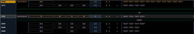

After executing 'Delete Cue 2061 Thru 2072':
This happens even if I merely move the cues to, say, cue 2080 to create a gap for additional cues. That's how I stumbled across this very strange behaviour.
Essentially this makes me never want to move Cues, which I up to now considered an unproblematic way to tidy up my numbering.
