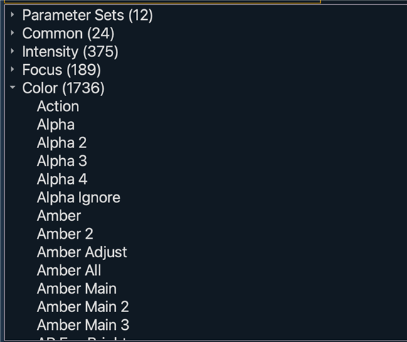

  • You'd actually would need this list in an excel sheet...
    But... 375 parameters in the intensity category alone... it's wild.
