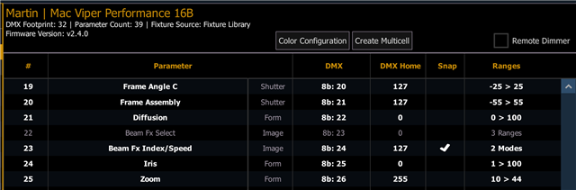

Hi! I'm currently running into a wall trying to record the Prism Rotation speed of our Mac Viper Performance lights onto a fader/sub master without it snapping on to the speed recorded to the sub. I’m using an Ion console with a fader wing and was able to record the gobo rotation onto a fader at a variable speed. Using the same syntax (Ch X thru X [Gobo Index/Speed] [Record] Sub X) for the Beam Fx/Speed parameter the result is one speed snapping up with any level of the fader. I’ve tried changing the sub master properties but to no avail. Have you had this issue? How did you work it out?
