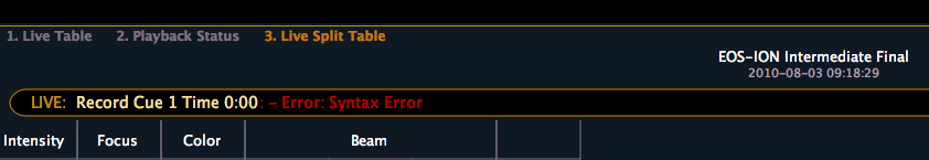

Hi,
I have noticed that typing [Record] [Cue] [n] [Time] [n2] [Label] [Teeeeext] and then using the [Backspace] button on the touchscreen-keyboard will bring up a Syntax Error instead of just deleting the last letters...
Below are two screenshots.
Not a big problem really..just thought it could be posted..
-Matze

  • Thanks for the report!!
    We are able to reproduce this issue in-house.
    This issue will be submitted to the development team A.S.A.P.
    And I will let them know the problems that this issue is causing.
    The only workaround that I can find has already been stated in an earlier post (by matzestrobel):
    Terminate the command line before labeling.
    -Chris-
