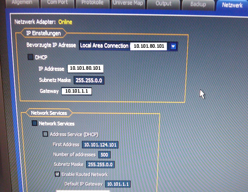

  • Hi Jaeiden,
    1.) Congo Software v6.1.1 has released. Please download the it from our website and install it on your console(s).
    2.) Did you download aRFR Software from our forum, or from the Android Marketplace? Did you purchase it?
    If you did not download from the Android Marketplace, please do this and reinstall on your device.
    3.) Set the Congo IP: 10.101.80.101; Subnet Mask: 255.255.0.0; Gateway IP: 10.101.1.1 ; Like this:
    4.) Do not check the DHCP Box by the Congo IP Setting. Unless you have an experienced Network
    Administrator setting your network settings, never have your console set to DHCP IP.
    5.) If you do not need them elsewhere, please turn the Network Services off, by making sure the
    check box is left blank (as above).
     6.) Set the WLAN Point/Router Address to 10.101.124.101; Subnet: 255.255.0.0; Gateway IP: 10.101.1.1;
     7.) Connect to the WLAN Point with your Android device and in the Android device, set a Static IP of 10.101.125.101
    "It's a little tricky...understand why you had trouble.
    Go into settings, wireless & networks. If you haven't all ready done so,
    connect to wifi. Once connected, PRESS AND HOLD the wifi network.
    Click "modify network" and you'll see an option for "IP settings." Click the DHCP
    and set it to static. Then enter in the IP: 10.101.125.101; Subnet Mask: 255.255.0.0; Gateway IP: 10.101.1.1
    More information about this:
    http://www.thriveforums.org/forum/toshiba-thrive-help/832-how-change-network-dhcp-fixed-ip.html
     8.) None of your devices should have a Subnet Mask of 255.255.255.0, because then nothing will communicate.
    Please make sure the Subnet Mask of all devices is 255.255.0.0.
    Once you do all this, you should be able to connect with no problems.
     Have fun!
