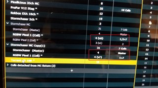

Patching the Blizzard StormChaser fixture with multi-cell (seven cells). As shown in the attached, the original has six cells out of seven defined as RGBW ( 4(x6) ) for cells 1,3 thru 7 and then one cell defined as a RGBW but ( 3(x1) ) for cell 2, leaving out the white. I made a copy as is shown and redefined all seven cells as RGBW ( 4(x6) ) to correct. Please update the distributed library.
